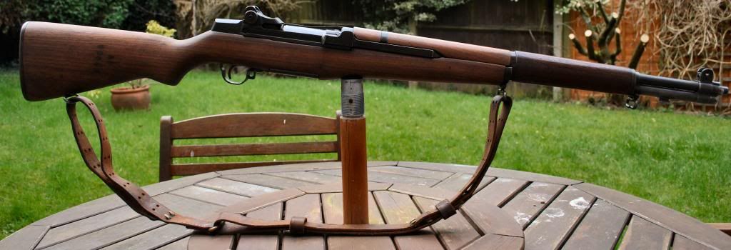

Teee Heeee
Do you mean like mine?

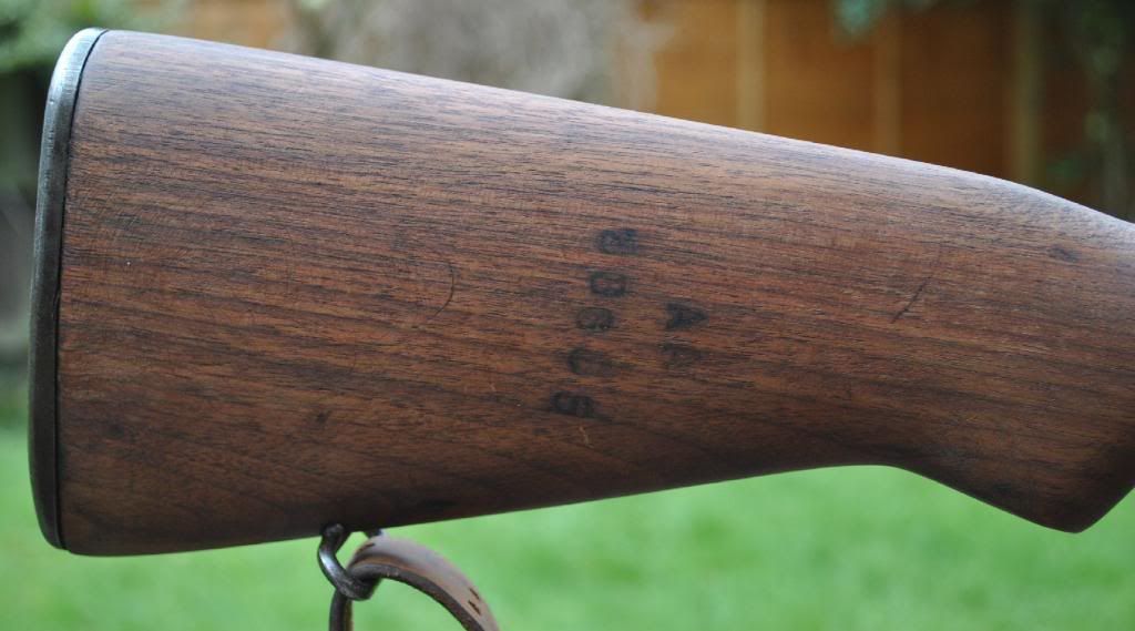

Wish I knew what the serial number on the stock meant, it is preceded by AA, American Airborne perhaps?
Sorry, I couldn't resist a bit of teasing

Very Very Nice ! I'm not jealous !

NICE!
Hi Paul and nope AA is nothing to do with Airborne. AA is an arsenal marking, at some time in it's life your rifle has gone back to one of the then rebuild arsenals and had a makeover. Your rifle went to the Augusta Arsenal in Georgia for it's makeover.
Typical stamps would be "RRA" for Red River Arsenal", "SA" for Springfield Arsenal,"AA" for Augusta Arsenal, "RIA" for Rock Island Arsenal, or any number of Government arsenals that ran official rebuild programs. As for the serial number below it, well the US arsenals never stamped serial numbers on the wood so the serial number on the butt is an indication that the rifle was issued or sold to an allied army who later stamped the serial number on it.

Hi Paul,
I don't know what your interest in these nasty old Service rifles is....get yourself a nice modern and very boring target rifle...to help you on your way I will take the Garand off your hands as an act of kindness!
Or how about a straight swap for another classic rile...a 1969 BSA Super Meteor, mint in the box with documentation.... lethal out to a staggering 25yds (if the wind is behind you) the ammo's a lot cheaper mate! :lol: :lol:

Thanks for that Blu, mystery finally solved.

Thanks HV for the kind offer to relieve me of the burden of owning the M1, believe me, I've had a hard time over the years of trying not to grin when I shoot it. Wouldn't want anybody to think that it's enjoyable. I've also had to fight people off when trying to record the 'Garand ping' for use as a ring tone.
So as you can see, it is all becoming too much of a burden so regarding your offer, I just might consider taking you up on it.
Right I've considered it and as I already have a 1960 BSA Meteor (it's what started it all) I'm afraid I'll have to decline and soldier on.
