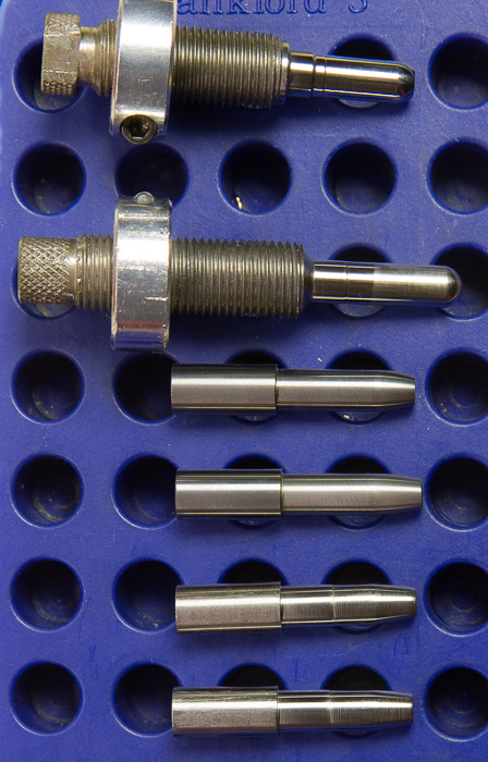

Re: Neck tension for .308Win (again ...)
Here's a bunch of different expanders to illustrate.
Top to bottom:
1: Original Lyman 'M' Die stepped expander (.307/.311).
2: Buffalo Arms stepped expander (.306/.311) [available in many different sizes]
3: Sinclair Carbide Turning Mandrel (.306)
4: PMA Tool Carbide Expander Mandrel (.307) [it looks like Sinclair may now offer an equivalent].
5: Custom stepped expander for Sinclair die (.304/.309).
6: Custom stepped expander for Sinclair die (.304/.310).
If your goal is to reduce runout I'd avoid the M die, as they can actually induce more runout, especially compared to the floating mandrel design of the Sinclair die. I made M-Die style stepped expanders for my Sinclair floating die body to have the best of both worlds (well almost; they aren't carbide so these were designed purely for the step/flare function, to be used after expanding using the .307 carbide mandrel, hence the undersized .304 starting diameter).
Although mainly for lead bullet users, stepped expanders are also popular with progressive reloaders, since they provide an on-press alternative to chamfering, they facilitate reliable automated bullet dropping and they lock the bullet into a nice square starting alignment. This depends on having sufficient neck clearance in the chamber to accommodate a tiny bit of case mouth flare, or careful use of a taper crimp to close the flare afterwards.
I've run all of these without dedicated neck lube on the ID, and currently run the carbide expander after de-lubing and often on stainless tumbled brass. There's a little sticking on withdrawing the mandrel, but not enough that I worry about it. The carbide mandrel in the photo was cleaned with 2 twists in cotton cloth with a drop of solvent after about 2,000 rounds loaded. The steel mandrels really need cleaning with polish, so they'll be loosing some microns on cleaning (say every few hundred to 1,000 rounds loaded).
A bit more about 'M' Dies for anyone interested:
The M Die body comes in two sizes: M-1 and M-2. There are actually 3 Lyman part numbers for .30 cal die-body/expander assemblies (7349002, 7349003, 7349004) which cover different expander and die-body combinations, so take great care to get the right one if ordering one of these.
The plug separates from the threaded part of the expander (as shown on right in photo above); it's worth using some loctite here.
The Buffalo Arms expanders come with cross-bolt lock rings which help preserve setting when dismantling for cleaning. The lock rings can be obtained separately for use with original Lyman expanders.
With all the steel expanders a high polish helps reduce friction and galling.
These are a couple of useful guides to M dies (the first has disappeared from its original location, so the link is to the web archive):
https://web.archive.org/web/20141223090 ... nMDies.htm
http://ps-2.kev009.com/ohlandl/Cast_Bul ... Plugs.html
