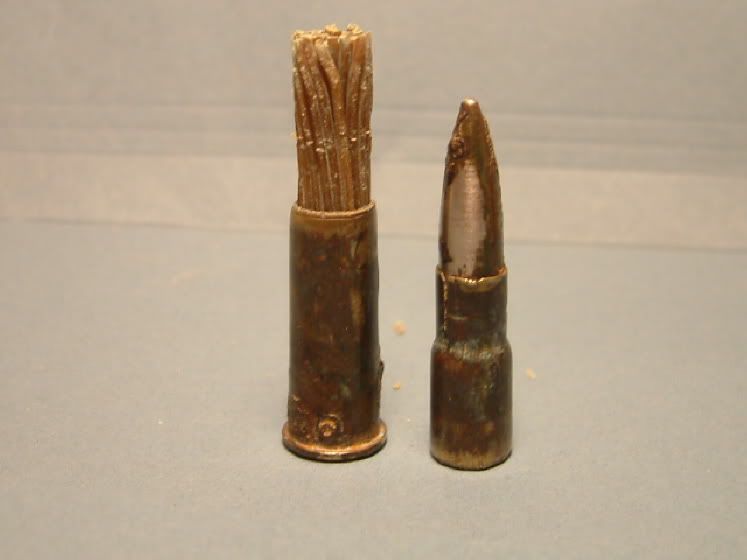

dromia wrote:
Mike357 wrote:Many thanks for the kind offer. I'll keep that in mind. Do you know how much powder is the military 174gr ball ammo?
Depends on manufacturer, cordite was used a lot. Around 44 strands were made into a "rope" and a measured length (1.55" - 1.6") weighing around 37.5 grains was cut into the case. If nitro cellulose was used the nominal weight was around 41gns. Obviously the charge would be adjusted slightly to give the speccied perfomance depending on the batch of propellant. This is for MkVII ball.
Cast boolits is the way to go to get the best from your rifle.
I've had over a dozen genuine No 5s through my hands over the years and never found them to have any accuracy problems, all giving at least 4" groups at 100 yrds with issue ball. Two inch groups were possible with handloads and I'm sure some most would do better again with more load development and better sights.
Below, a cartridge recovered from the battle field at Loos. It was given to me along with some other bits and pieces by a French Farmer whilst I was walking the line of advance made by the 1/4th Leics on October 13th 1915. Could even have been dropped by my Great Uncle. The cordite was wet, but once dried a strand burnt as vigourously as the day the cartridge was loaded.
