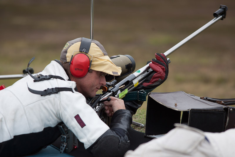

Here's a left hand 3-lug action (the 'Super Target 200', or ST200) in the first generation aluminium stock being used for MR.Hauptman wrote:Is the action strong enough to take the sort of battering that MR would inflict, for example? How does it compare with the Swing or the Paramount?
