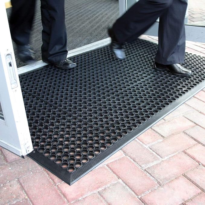

#4 Post by ovenpaa »
We use this sort of thing in the workshop over concrete and sheet chalk. They do insulate your feet from the cold, isolate swarf and dirt and are easily moved for cleaning.

#5 Post by Polchraine »
A mat or carpet will make it fell warm under foot but there is still a need to isolate or insulate from the massive cold thermal mass.

#6 Post by johngarnett »
Thank you all. Yes, I do have floor insulation from the rest of Cornwall! Rubber matting with knobbles to keep off the floor.
Heating wise, I have resorted to my finned oil filled radiator. At least it's warming up now!!
