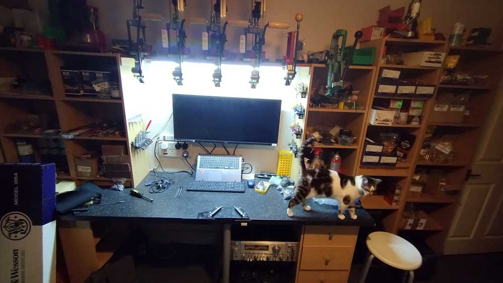

- phaedra1106
- Posts: 3429
Re: Ikea Desk for reloading press / any need to strengthen?
Ikea do a 70cm steel leg (Adils) for £2.50, comes in white or black. if you can manage it put one under the bench where the press sits.
https://www.ikea.com/gb/en/p/adils-leg-black-70217973/
Or stick some 38mm Ikea worktop on it!
The cat is optional
The cat is optional
