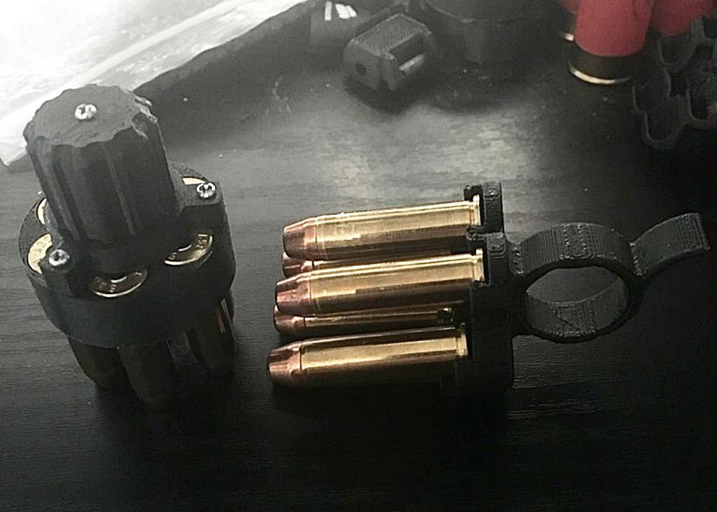

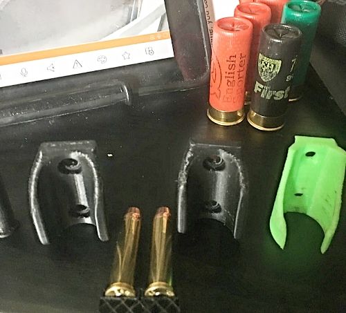

I've been playing with the settings & started to get some improved results with a few things.
Made some boing cable end covers, some .357 dummies to use as snap caps, working on a speed loader for my Alfa LBR (part of it is inbetween the 2 black matchsavers) & some match savers for 12G below
Progression was from right to left for the Match Savers, the loaded one 2nd photo & far left in the 1st is the best so far & I can even tweak the size to a specific cartridge as there are some slight size discrepancies between brands & loads.
Good job I've got a week off as I've got LOTS of other ideas :oops: lol

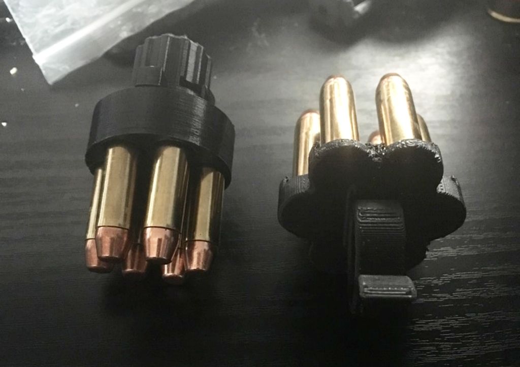

Been busy again today :D
Speedloader on the left is printed in 4 parts & clicks release & locked with a twist, also needs 4 screws, a spring from a pen & a .177 BB (Which are in the cap).
It fits my Alfa .357 spot on, not as quick to use as my Safariland Comp II's but it did cost less than 50p to make :p
The one on the right is a work in progress as I need to change the dimensions for the cartrige spacings & tweak the design so it doesnt foul on the handgrip while inserting the bullets into the cylinder. The idea is that you insert into the cylinder with the gun at a 45 degree downward angle & then pull down or sideways on the loader to release the rounds to drop into the cylinder freely.
Prototypes are printed in PLA but I will be printing my ones to use in PET-G or ABS for prolonged life & durability.
