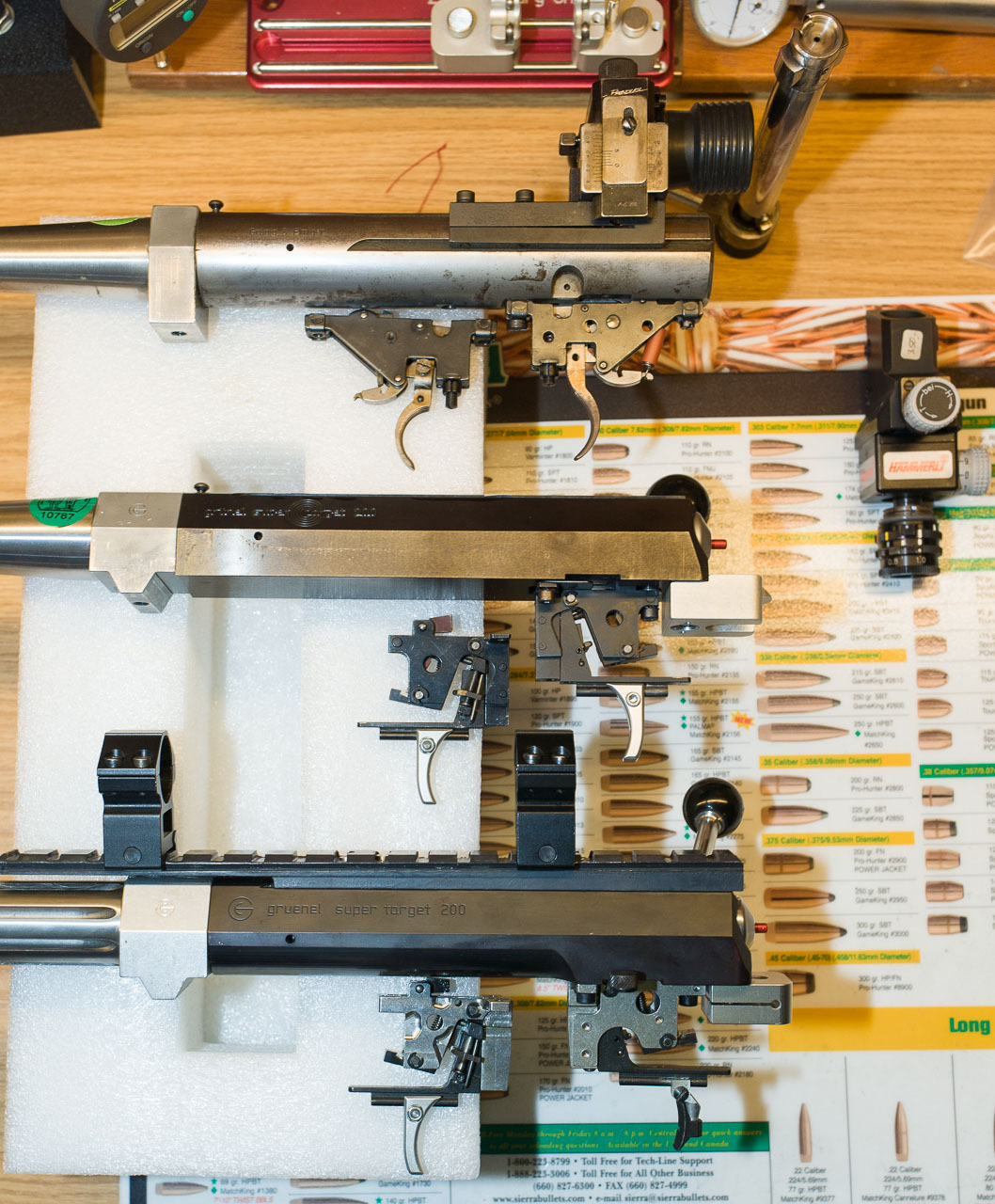

Does anyone know what kind of trigger fits these receivers, I read somewhere it was anschutz but which models?

dirge wrote:Does anyone know what kind of trigger fits these receivers, I read somewhere it was anschutz but which models?
I don't know the part number, but I can show you a photo.
- Top is the round action 2-lug with Anschutz trigger.
- Middle us an early (80s) ST200 action with Grünig trigger (plate frame).
- Bottom is a late (2000's) ST200 action with Grünig trigger (machined frame).
Re: 1983 Grunig Elmiger as basis for f class/target rifle
The trigger is the old Anschuetz one wjth the steel housing, but with the top lever slightly modified to suit the G+E sear lever who is part of the action itself. A first class trigger.dirge wrote:The scope is only 24x, but will suffice for the first learning stage which will probably be at 300-600.
R.G.C
Rox,
There is one spring missing on the repressented trigger!!
R.G.C
Well spotted! Gold Star.R.G.C wrote:Rox,
R.G.C

So it's not a standard anschutz trigger, dang as I have one I wanted to swap in but I don't want to modify it.
The modification iseasy to made. Just grind off the sear hppk pn the Anschutz trifgger lever.dirge wrote:So it's not a standard anschutz trigger, dang as I have one I wanted to swap in but I don't want to modify it.
