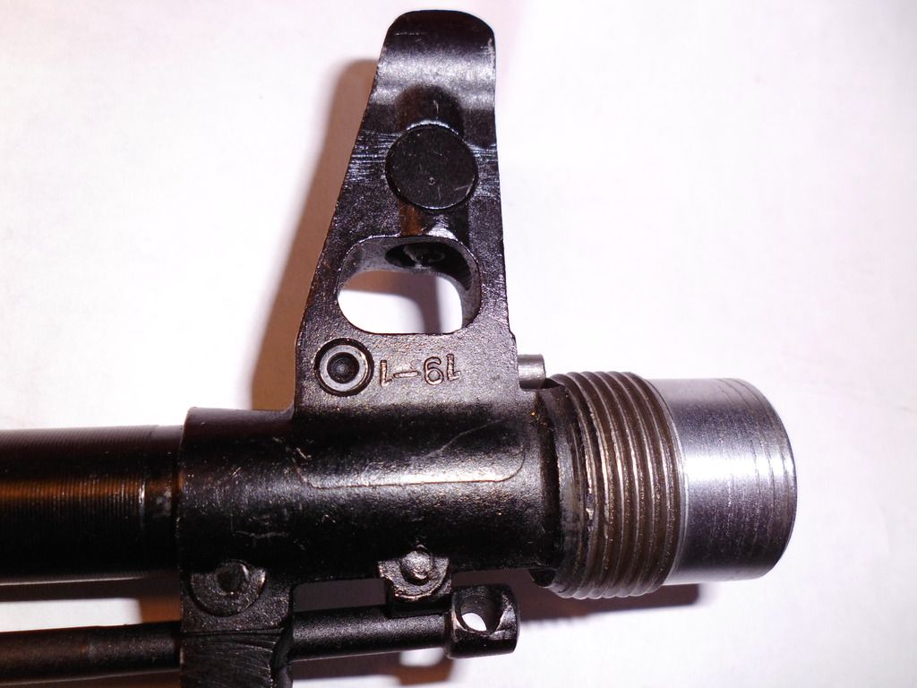

My old Saiga 103 was accurate with the muzzle brake (as they are designed to be) and was the most accurate of all the AK variants I've owned.The brake will unscrew from the front sight block if you push the detent pin in and unscrew it....bearing in mind it is a lefthand thread and the brake may well be seized on if its never been off.With mine there was no noticeable difference in accuracy with the brake on or off, my Romy AKM is the same.
The brake on the 103-based Saiga the brake shouldn't be pinned and welded, that is normally done on the 104-based carbine in order to comply with barrel/overall length requirement.
The thread is indeed integral with the sight block and if you really want to change the front sight block I have a spare one from an AKM knocking about somewhere you are welcome to but I believe the journal size may be slightly different as the AK-100 series/Saiga's use an AK-74 barrel profile.If it helps the AKM FSB journal size is .572"

Edit.....it may be a daft question but is your front sight block definitely pinned?, just wondering as on later Saigas it was retained by two pressed "dimples" on either side......if it is dimpled these have to be drilled out before the sight block can be removed.The sight post can be removed using a two leg bearing puller, a suitable metal plate to sit behind the sight post and a piece of brass rod with one end turned down to 7.6mm to fit inside the barrel and the other end suitably sized so the internal bore of the sight block with pass over it......those sight posts can be very tight and trying to whack the barrel through the post may well be too much for a nylon drift!.....failing that find someone with a workshop press, that will soon remove it.

This is the current sight block. I could just make life easy and have the threaded section machined off but it seems a waste.
